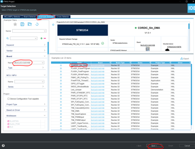

2023-08-16 4:07 PM
In STM32CubeIDE, go to File -> New -> STM32 Project.
Go to the Example Selector tab.
Choose your board, then choose a project, then hit Next and create it.
