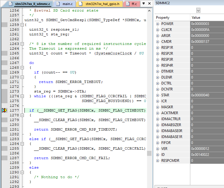

I am still having problems with my custom board, which is Stm32H753, SD in 1 bit mode, Input clock 200Mhz, SDMMC2 interface as SD, with clock divide by (3+1), no transceiver. It always fail in SD_PowerON(). I traced it to SDMMC_CmdAppCommand(), where it sends 0x37 and expects the same comes back from RESPCMDR registers. There was no timeout or CRC errors, just the RESPCMDR was 0.
I have attached a screen capture. I am not familiar with SD cards, please help.
The pins for SD are PD6(CLK), PD7(CMD), PB14(D0), all are high speed AF, with internal pull ups. I am using CubeMX 6.8 with H7 package 1.11.0.

Still no luck yet. A question I have is about pins: Looking at the schematics of my board, it is in 1 bit SD mode. D1-D3 on the card slot side are left floating, should they be pulled? And for CLK/CMD/D0 are internal pullup (40Koms) enough?
