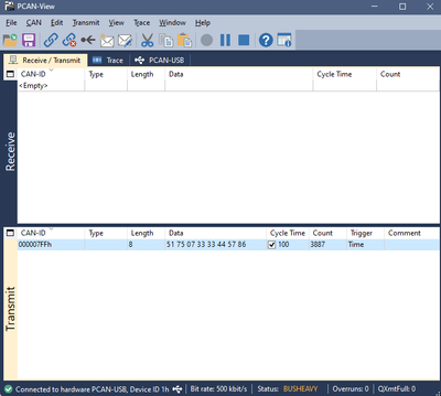

how can i fix the busheavy problem ? anyone can help me please ?

2023-08-16 10:54 PM
its Pcan view status its looking on last photo. That means my code is wrong but hardware is true. I want to make can communication with STM32F103C8Tx
