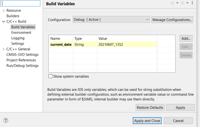

I want the IDE to save inside a buildinfo.h various const strings containing build timestamp names and other system variables.
But im unable to use them inside my pre-build script:

2021-06-07 12:32 PM
The eclipse variables can be substituted in the command line, but not in the script file itself.
Try to change the command so:
cd..;./script.sh ${current_date}

2021-06-07 5:35 AM
I first tested
#!/bin/sh
echo "this is the pre-build script!:D"
echo "static const char BUILD_INFO[] = \"build_date=${current_date}\";" > buildinfo.hand this got generated inside buildinfo.h:
static const char BUILD_INFO[] = "build_date=";:(
