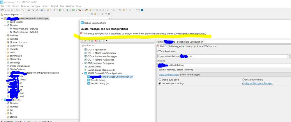

Our project firmware is build using cmake. Cmake is used to create Eclipse project like this
cmake ..\Firmware -G"Eclipse CDT4 - Ninja" -DCMAKE_ECLIPSE_VERSION=4.16
I can import project to CubeIde without proplems and buid it there. Proplem is that CubeIde debugger configuration does seems to accept project as valid project for debuged in stm32.
I have also created bootloader using CubeIde and that I can use for debugging and I have attached Firmware elf to be loaded when BL is debugged. This is workaround to make possible to use CubeIde debugging our firmware.
I attach photo Eclipse error message when configuring debugger
How I should modify our Firmware project so that CubeIde can use it directly to debugging?

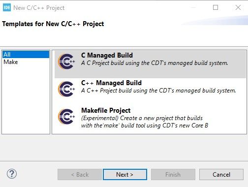

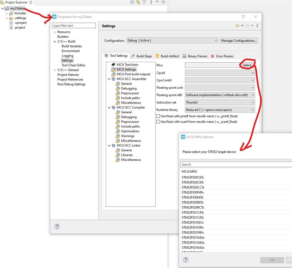

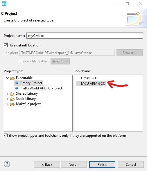

At that time STM32CubeIDE only support STM32Cube debug facilities if you're relying on STM32 toolchain.
Maybe you can mix following setup to your cmake project .... all such is just about project .metadata (i.e. .cproject file content).
Here you're: you have a STM32 target device defined and so full access to STM32Cube debug facilities.
Nobody is forcing you to use CDT managed build setup ... just rely on cmake to build but debug is available to you once your binary file is availabe thru cmake
