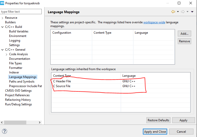

If not, my second plan of attack is to force use of the g++ compile on all the .c files using the language mapping dialog, this way I can continue to use the auto generation while using c++ features:
However this does not seem to have an effect and the c files are still compiled with gcc:

As of the previous update, STM32CubeIDE/STM32CubeMX was not set up to generate C++ directly. Not sure if the latest update changed it.
