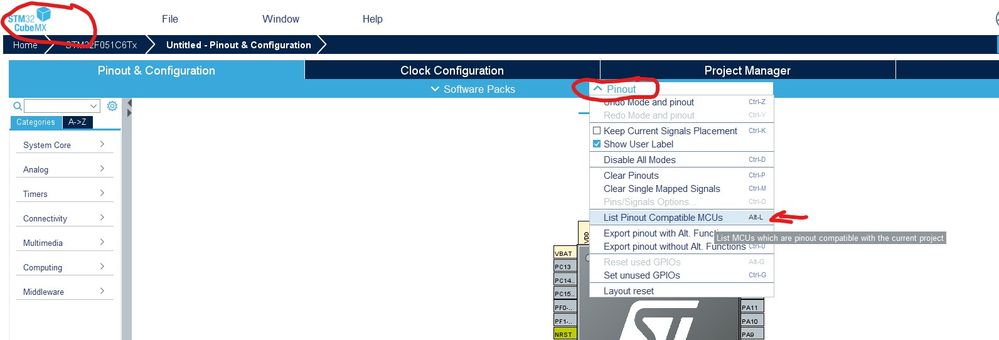

STM32CubeMX is supporting such
Please consider too: How do I change the MCU in CubeIDE project (st.com) plus be aware IDE is able to support as many build configuration as you want ... so possibly define some per targeted devices (point per each to dedicated linker file etc ...)
