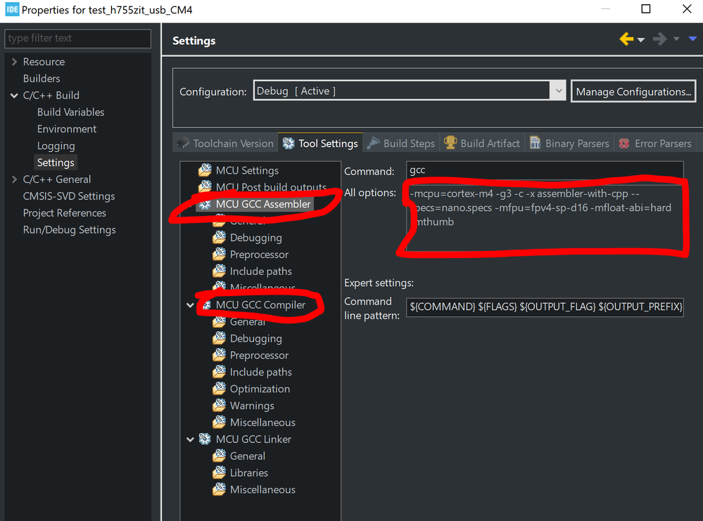

Right click project -> C/C++ Build -> Settings -> Tool settings
They are changed from within there.
