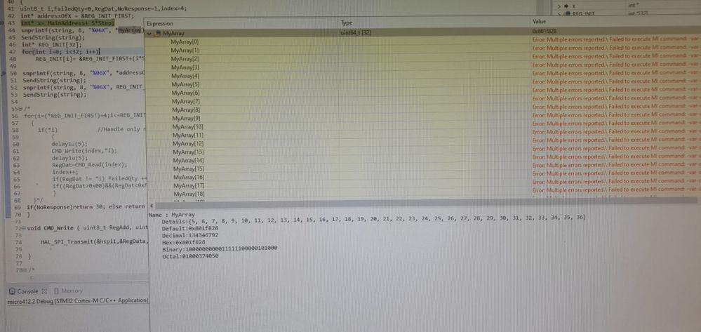

#define MyArray *(uint64_t (*)[32])(MainAddress+ 5*Step)
I cannot access the values ​​in the array but only the whole array. Although the IDE shows me all the (correct) values ​​in the array:
snprintf(string, 8, "%06X", MyArray);
what should i do?
