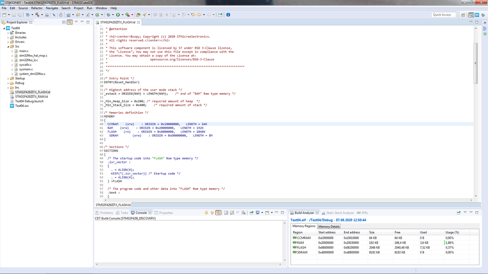

Add it too the linker script (.LD) as a named section
Would be 0xC0000000 or 0xD0000000 depending on the bank

thank you! I did it, but why used 0B can you help me

> why used 0B
Are you storing any variables in there that the linker knows about? If not, it'll show as 0 bytes used.
