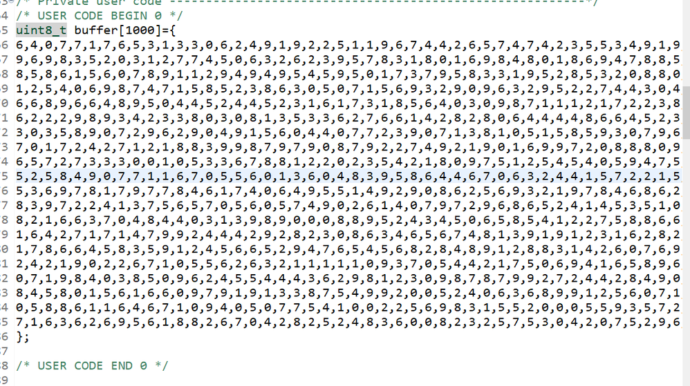

should i use the pointer as below?
uint8_t buffer[1000]={
6.4,0,7,7,1,7,6,5,3,1,3,3,0,6,2,4,9,1,9,2,2,5,1,1, 9.6,7,4,4,2,6,5,7,4,7,4,2,3,5,5,3,4,9,1,9,4,9,3,4,
9.6,9,8,3,5,2,0,3,1,2,7,7,4,5,0,6,3,2,6,2,3,9,5,7, 8,3,1,8,0,1,6,9,8,4,8,0,1,8,6,9,4,7,8,8,5,1,8,4,3,
8,5,8,6,1,5,6,0,7,8,9,1,1,2,9,4,9,4,9,5,4,5,9,5,0, 1,7,3,7,9,5,8,3,3,1,9,5,2,8,5,3,2,0,8,8,0.5,5,1,1,
1,2,5,4,0,6,9,8,7,4,7,1,5,8,5,2,3,8,6,3,0.5,0,7,1, 5,6,9,3,2,9,0,9,6,3,2,9,5,2,2,7,4,4,3,0,4,3,5,7,
6,6,8,9,6,6,4,8,9,5,0,4,4,5,2,4,4,5,2,3,1,6,1,7,3, 1,8,5,6,4,0,3,0,9,8,7,1,1,1,2,1,7,2,2,3,8,3,1,1,3,
6,2,2,2,9,8,9,3,4,2,3,3,8,0,3,0,8,1,3,5,3,3,6,2.7, 6,6,1,4,2,8,2,8,0,6,4,4,4,8,6,6,4,5,2,3,8,7,4,9,
3,0,3,5,8,9,0,7,2,9,6,2,9,0,4,9,1,5,6,0,4,4,0,7,7, 2,3,9,0,7,1,3,8,1,0,5,1,5,8,5,9,3,0,7,9,6,0,8,6,6,
7,0,1,7,2,4,2,7,1,2,1,8,8,3,9,9,8,7,9,7,9,0,8,7,9, 2,2,7,4,9,2,1,9,0,1,6,9,9,7,2,0.8,8,8,0,9,3,7,7,6,
6.5,7,2,7,3,3,3,0,0,1,0,5,3,3,6,7,8,8,1,2,2,0,2,3, 5,4,2,1,8,0,9,7,5,1,2,5,4,5,4,0.5,9,4,7,5,2,2,4,3,
5,2,5,8,4,9,0,7,7,1,1,6,7,0.5,5,6,0,1,3,6,0,4,8,3, 9,5,8,6,4,4,6,7,0,6,3,2,4,4,1,5,7,2,2,1,5,5,3,9,7,
5,3,6,9,7,8,1,7,9,7,7,8,4,6,1,7,4,0,6,4,9,5,5,1.4, 9.2,9,0,8,6,2,5,6,9,3,2,1,9,7,8,4,6,8,6,2,2,4,8.2,
8,3,9,7,2,2,4,1,3,7,5,6,5,7,0.5,6,0.5,7,4,9,0,2,6, 1.4,0,7,9,7,2,9,6,8,6.5,2,4,1,4,5,3,5,1,0,0.4,7,4,
8.2,1,6,6,3,7,0,4,8,4,4,0,3,1,3,9,8,9,0,0,0,8,8,9, 5,2,4,3,4,5,0,6,5,8,5,4,1,2,2,7,5,8,8,6,6,6,8,8,1,
1,6,4,2,7,1,7,1,4,7,9,9,2,4,4,4,2,9,2,8,2,3,0,8,6, 3,4,6,5,6,7,4,8,1,3,9,1,9,1,2,3,1,6,2,8,2,4,5,8,6,
1,7,8,6,6,4,5,8,3,5,9,1,2,4,5,6,6,5,2,9,4,7,6,5,4, 5,6,8,2,8,4,8,9,1,2,8,8,3,1,4,2,6,0,7,6,9,0,0,4.2,
2,4,2,1,9,0,2,2,6,7,1,0,5,6,2,6,3,2,1,1,1,1,0,0, 9.3,7,0.5,4,4,2,1,7,5,0,6,9,4,1,6,5,8,9,6,0,4,0,8,
0.7,1,9,8,4,0,3,8,5,0,9,6,2,4,5,5,4.4,4,3,6,2,9,8, 1,2,3,0,9,8,7,8,7,9,9,2,7,2,4,4,2,8,4,9,0,9,1,8,8,
8,4,5,8,0,1,5,6,1,6,6,0,9,7,9,1,9,1,3,3,8,7,5,4,9, 9.2,0,0.5,2,4,0,6,3,6,8,9,9,1,2,5,6,0,7,1,7,6,0,6,
0.5,8,8,6,1,1,6,4,6,7,1,0,9,4,0.5,0,7,7,5,4,1,0,0, 2,2,5,6,9,8,3,1,5,5,2,0,0,0.5,5,9,3,5,7,2,9,7,2,5,
7,1,6,3,6,2,6,9,5,6,1,8,8,2,6,7,0,4,2,8,2,5,2,4,8, 3.6,0,0,8,2,3,2,5,7,5,3,0,4,2,0,7,5,2,9,6,3,4,5,0,
char *bufferp = &buffer;
int length=sizeof(*bufferp);
printf("buffer total: %c\r\n",*bufferp);
printf("length: %d", length);

"uint8_t buffer[1000]={"
You have the size of the buffer right there!
Why not just do:
#define BUFFER_LENGTH 1000
uint8_t buffer[BUFFER_LENGTH ] = {Then you have BUFFER_LENGTH available to be used wherever you need it!
2022-05-11 3:48 AM
That's going to be the size of the pointer.
Pass like
foo (buffer, sizeof (buffer));
Where
void foo (uint8_t *buf, size_t size)
printf ("size %d\n", size);
