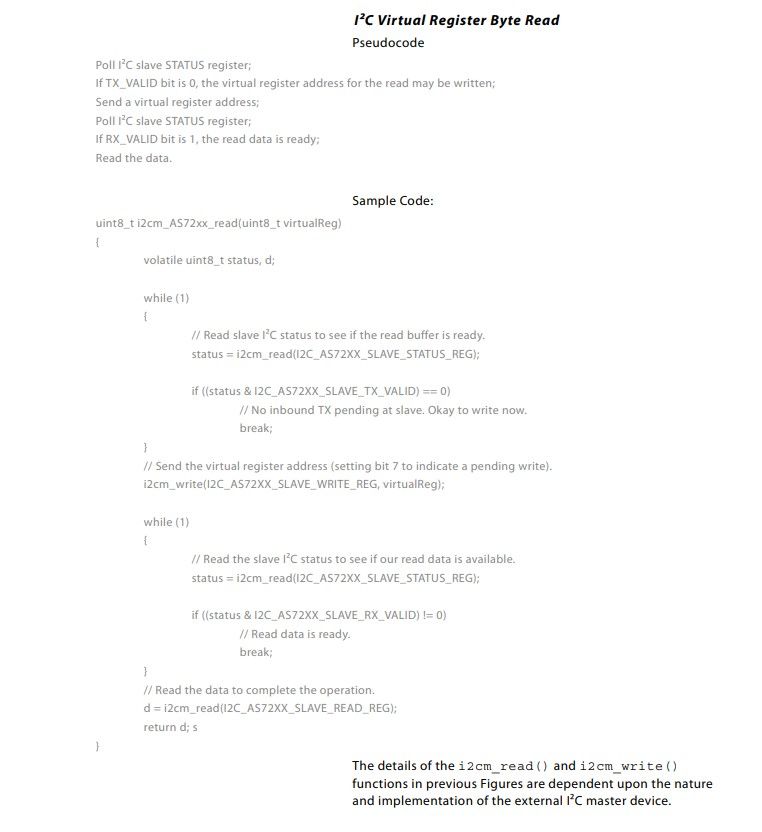

2022-05-12 8:20 PM
I think I have made a mistake in programming, I have attached the picture of pseudo code and sample code image from datasheet, can you please confirm whether my code and the sample code matches?
