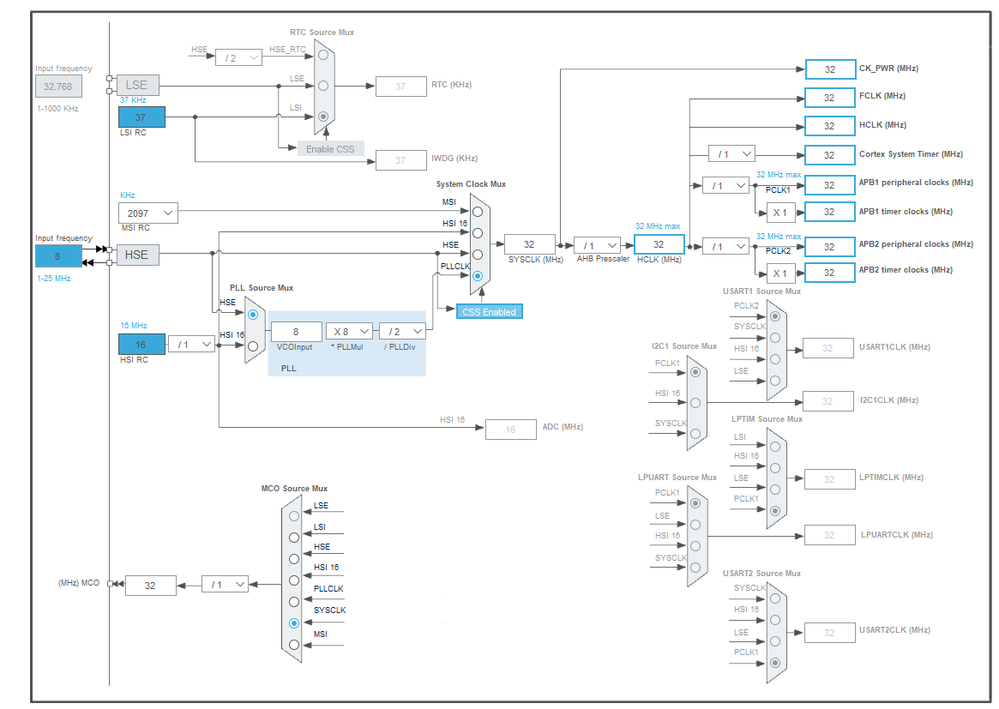

2022-02-25 6:28 AM
External XTAL works as expected. and configuration is as in the picture shown.

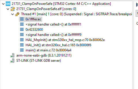

I will check Flash wait states...
HSE starts and SysTickTimer is counting. it seems no SysTickInterrupt is thrown?
see picture below

2022-02-25 8:17 AM
So mapping of zero address space, and vector table.
Would explain the 0x1FFFxxxx address in the stack-dump
