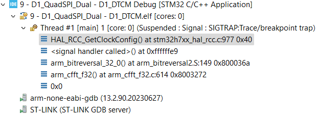

It seems that the call / execution of the FFT function crashes if run in the single QSPI mode. I can set a breakpoint on the function but as soon as I try to step over it
the debugger jumps to this line here in HAL_RCC_MCOConfig() function
which doesn't make much sense to me.
The debug window shows

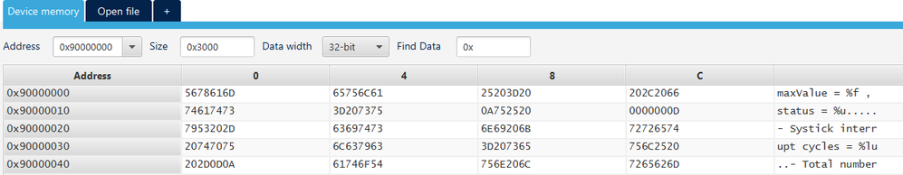

*arm_cfft_f32.o(.text .text*)After running the demo in the CubeIDE, I can see in the CubeProgrammer that the code & data has been programmed into QSPI flash (I've erased the entire flash before):

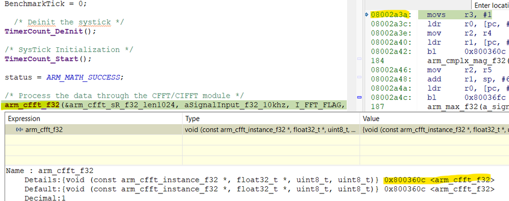

But according to the IDE debugger, the program code is executed from the internal flash:
I guess that the linker script here is not suitable to locate the FFT function code into the QSPI flash:

Regarding the constant data, these are placed into QSPI memory (Cube Programmer QSPI read):
Nevertheless, the .list file claims that the function code has been placed to internal flash:
0800360c <arm_cfft_f32>:
800360c: 2a01 cmp r2, #1
800360e: e92d 41f0 stmdb sp!, {r4, r5, r6, r7, r8, lr}
8003612: 4606 mov r6, r0
I guess that there is a problem with the linker script. Seems to me that only constants are placed to QSPI but code is placed to internal flash.
