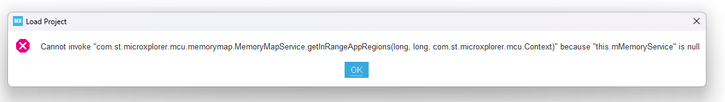

I attached the demonstration IOC file. I created new project for STM32N6570-DK board, enabled RAMCFG peripheral for Appli, checked the AXISRAM3-6 areas, defined single continuous area for those SRAMs in MMT and saved the project. After this CubeMX fails to load this IOC file. I get popup:
In textual form the error is: Cannot invoke "com.st.microxplorer.mcu.memorymap.MemoryMapService.getInRangeAppRegions(long, long, com.st.microexplorer.mcu.Context)" because "this.mMemoryService" is null.
The workaround is to not enable RAMCFG in CubeMX, rather control the peripheral manually.

Issue is fixed in the latest STM32CubeMX release 6.17.0 available here.
KR, Souhaib
