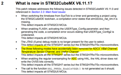

after updating to STM32CubeIDE 1.15.0 with H7 Package 1.11.1 H7 ADC3 does no longer offer selection for Temperature Reference, VBat and Vrefint Channels. Screenshot was made with V1.14, missing selections are marked : - ]

Hello All,
This issue is fixed in the latest patch release of STM32CubeMX v6.11.1.
Thank you for your contribution and for your patience while we worked on this.

I have seen, that the new version 1.15.1 offers the ADC3 selection for temperature, vref an vbat again.
Thanks for the repair.
