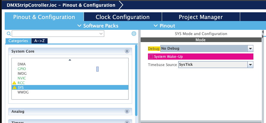

OK Found it!
Somehow I have set debug to "No Debug" - Must have been me, but I don't recall ever going there!
Changing ti back to Serial Wire debug fixes it.

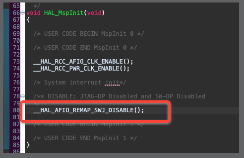

If I step into HAL_Init() it stops at this line:

@KMill wrote:If I step into HAL_Init() it stops at this line:
Look at the comment immediately above that line: you are disabling the JTAG and SWD - so obviously the debug connection will fail!
2024-09-25 3:21 AM
@Andrew Neil Aye, I see that! The question is why is it being disabled?
I am in a debug configuration, and the pins are reserved for debug!
I had a browse through the stm32f1xx_hal_msp.c but can't see any clues as to why that is there?
2024-09-25 3:35 AM
Are you overriding HAL_MspInit function? That function is usually defined as __weak

OK Found it!
