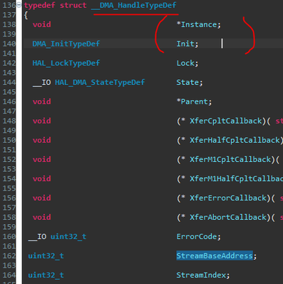

+) The issue has been solved, and I modified type of instance, member of __DMA_HandleTypeDef from void to DMA_Stream_TypeDef.
After checking files with DMA, there are no problems.
Isn't it a problem related declarations of UART_HandleTypeDef and DMA_HandleTypeDef, by any chance?
