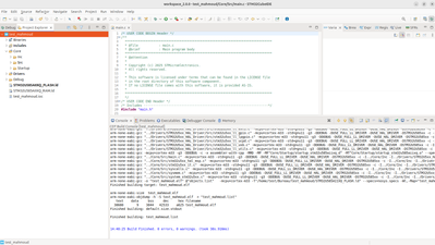

2025-12-12 5:58 AM
Hello @Jhend
I reproduced the test on Linux Arch and the build was completed with 0 errors.
