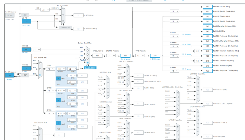

2021-06-09 3:01 AM
Are you using a XTAL as a HSEclock source?
How high is your system clock?
Maybe share a snap of your cubeMX page clock setup
2021-06-09 3:05 AM
Hi Javier,
Thanks for the answer here I send you a picture of the clock setup.

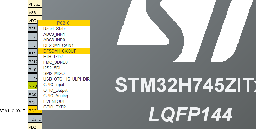

Hi Tesla Delorean
Thanks for the answer. Yes the pin I need to control is not realted to any TIM (pin PC2_C) hence I need to toggled it to make the clock.
Regards
Alan
2021-06-09 7:26 AM
@ABlum.2 That pin has the DFSDM1_CKOUT option.I never used this peripheral but its meant for driving external ADCs so the DFSDM1_CKOUT pin can generate a very fast
pwm clock signal for you.
Did you tried this already?

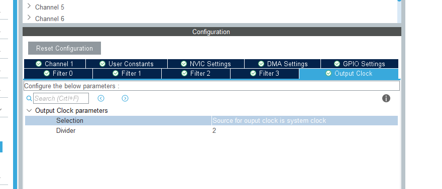

2021-06-09 11:52 PM
@Javier Muñoz thanks for the information, I will try this, where can I find this configuration from the image with the filters?
Regards
Alan Blumenstein
2021-06-09 11:54 PM
@ABlum.2 Are you reffering to cubeMX?
The configuration appears under DFSDM peripheral config tab
