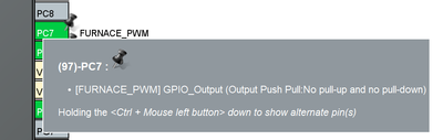

Pin PC7 is correctly set as GPIO output in the IOC:
And after generating code, it's correctly initialized as output within MX_GPIO_Init.
It looks like everything is behaving as intended. What makes you think it's not being initialized?
