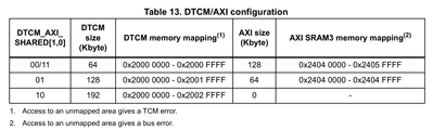

Did you set DTCM_AXI_SHARED option byte to allocate the max 192 kB to DTCM? Show in CubeProgrammer.

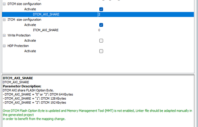

@TDK I set these bits via the MX tool:
and they appear to increase the memory size. However, specifying more than 64K in my code results in the .elf file not being able to be loaded in the debugger
