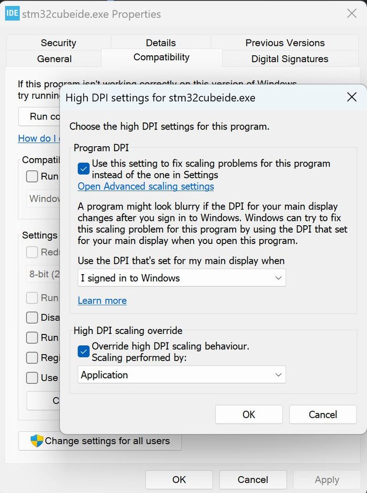

2023-03-27 9:49 AM
AWies, I don't know if you solved this? I had the same issue and had trouble finding a solution. I didn't find any actually. Finally, playing randomly around with the Compability settings I got the problem to stop. I ticked "on" these two settings in DPI settings. No idea what it does or means, but it worked.
