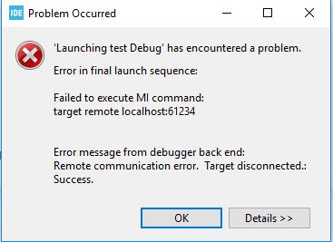

I am trying to debug my hardware for the first time. I was working in TrueStudio 9.3.0 as I had started this project in it before STM32CubeIDE came out. When I started to try to debug my program to day I got an error. OK, maybe I should try STM32CubeIDE instead. Loaded this up and got the project migrated with no problem. But when I go into the debugger it generates the same error and exits. I am not sure where to start to track this down. The console shows this:
STMicroelectronics ST-LINK GDB server. Version 5.2.3
Copyright (c) 2019, STMicroelectronics. All rights reserved.
Starting server with the following options:
Persistent Mode : Disabled
Logging Level : 1
Listen Port Number : 61234
Status Refresh Delay : 15s
Verbose Mode : Disabled
SWD Debug : Enabled
Waiting for debugger connection...
Debugger connected
Debugger connection lost.
Shutting down...
The detailed error message gives me this:
Error in final launch sequence:
Failed to execute MI command:
target remote localhost:61234
Error message from debugger back end:
Remote communication error. Target disconnected.: Success.
I am using an ST-LINK\V2. I can download the program just fine using STM32CubeProg so I know the ST-LINK and the interface is working correctly. Where do I go next to figure this out? Thanks.

I am getting exactly the same problem. A program using the Nucleo-64 with STM32L073RZ gives no problems, another program, even a blank new project, with Nucleo-64 with STM32L476RG gives
"Failed to execute MI command:
target remote localhost:61234"

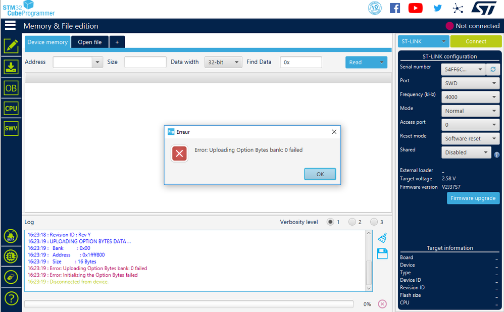

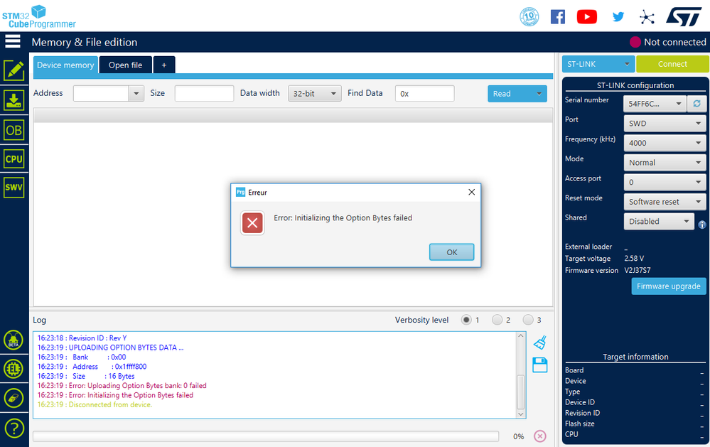

Hello, I hope someone had an answer to this problem since it was posted a year ago. I am currently trying to program an STEVAL-ESC001v1 board with an STLINK V2 ISOL probe. The IDE I use is the STM32CubeIDE. Before that, I used a regular STLINK V2 probe and the debugging of my program worked perfectly. Ever since I switched to the STLINK V2 ISOL (for isolation from power), I have been getting these errors on the console :
STMicroelectronics ST-LINK GDB server. Version 5.8.0
Copyright (c) 2020, STMicroelectronics. All rights reserved.
Logging Level : 1
SWD Debug : Enabled
InitWhile : Enabled
Debugger connected
Target is not responding, retrying...
Shutting down...
I tried using the STM32CubeProgrammer software, but It seems like the ISOL probe doesn't recognize the target :
Can anyone help me out with this issue ? Thank you very much
