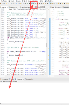

I cleared the console, and then clicked on Debug button or Run button as shown in the following picture, nothing happens:
I have not seen any error message so far.

I alway click on the bug icon which will launch the debugger for the project listed on top, also for run icon. I also tried to click on the arrow and select the project on the top, but nothing happens in the console window.
I can also see a message of "Launching Tunnel: 0% with a progress bar flashing away quickly, this means I did click the bug icon successfully.
