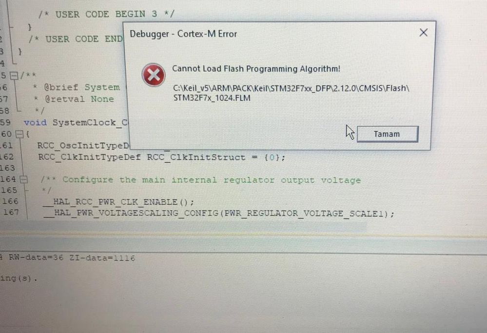

Hi , I have this error and maybe, keil make mistake which is "Cortex-M7 fault error ". Also, I have two KEİL IDE in different computers. Keil gives an error on one and not on the other.
