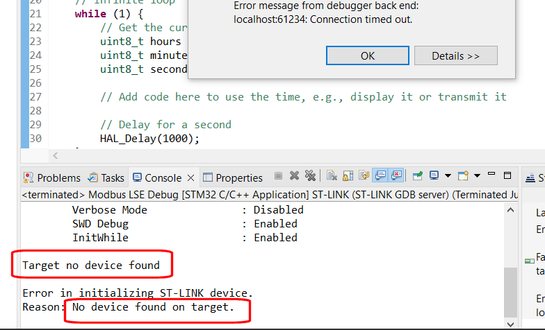

I'm new to STM32. I'm currently using STM32F103C8T6 board, and it give MI command error (image attached). I have tried using STM32 programmer as well to fix it. Still couldn't. How can i fix this?

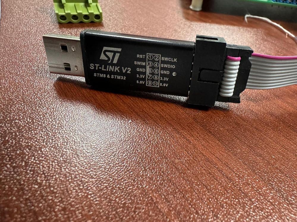

@Thenuk__a wrote:I'm using ST-Link V2.
That's a clone - not a genuine ST product.
Check your connections very carefully - different clones have different pinouts!

@Thenuk__a wrote:it give MI command error (image attached).
The important part of the message is here:
So it's not seeing your STM32.
2024-08-01 4:45 AM
Thanks. Changed the ST link and it worked
