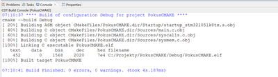

I have successfully created a new cmake project in IDE 1.16. Everything I need works - the project is successfully compiled, the BIN file is successfully run in the MCU:
[ 97%] Building C object CMakeFiles/KubergCMAKE.dir/Drivers/STM32L0xx_HAL_Driver/Src/stm32l0xx_hal_uart_ex.c.obj
[100%] Linking C executable KubergCMAKE.elf
text data bss dec hex filename
48528 128 3376 52032 cb40 C:/Projekty/KubergCMAKE/Release/KubergCMAKE.elf
[100%] Built target KubergCMAKE
13:57:54 Build Finished. 0 errors, 0 warnings. (took 16s.631ms)

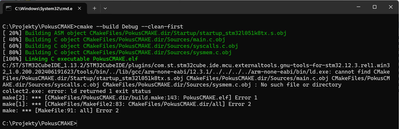

However, I am unable to compile the project from the command line window.
cmake --build Release
This command only succesfuly compile source files - 100% done, but when try to lining:
ends with this error:
CMakeFiles/KubergCMAKE.dir/Drivers/STM32L0xx_HAL_Driver/Src/stm32l0xx_hal_uart_ex.c.obj : No such file or directory
collect2.exe: error: ld returned 1 exit status
make[2]: *** [CMakeFiles/KubergCMAKE.dir/build.make:639: KubergCMAKE.elf] Error 1
make[1]: *** [CMakeFiles/Makefile2:83: CMakeFiles/KubergCMAKE.dir/all] Error 2
Has anyone solved the same problem?
