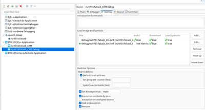

2024-08-01 4:57 AM
Hi I am still struggling with similar problems here but one thing that made a huge difference is to not use default break point I assume the standard example will run into misalignment with the power domain wait. so set you break point below this on the M7 core:
timeout = 0xFFFF;
while((__HAL_RCC_GET_FLAG(RCC_FLAG_D2CKRDY) != RESET) && (timeout-- > 0));
if ( timeout < 0 )
Error_Handler();
}And disable the default break point in Debugging Config / start up. This way the CubeMx proposed start up works and debugging does not mess it up.
In other works with this tweak the CubeMx example now in version 6.12 frame work 1.11.2 it works together with the process from AN5361 - It seems possible to get it running with default break point but it is way more itchy that way. I assume I have not fully understood what I am doing at this point but to get started this might be helpful trick.
