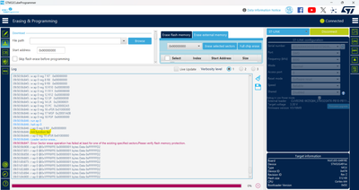

I am seeing Init function fail when i set log level to 3
Below is the reference screenshot

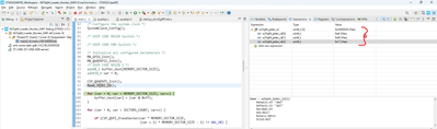

Device ID is reading correctly. For W25Q64JVSSIQ, Device is = 0xEF 40 17
// Manufacturer ID = w25q64_jedec_id[0]; // 0xEF (Winbond)
// Memory Type = w25q64_jedec_id[1]; // 0x40
// Capacity = w25q64_jedec_id[2]; // 0x17 for 64Mbit
CSP Implementation Screenshot:
