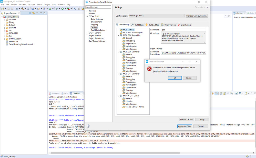

I am using the above board, downloaded the example project and followed all procedure as per the readme.txt.
Though I had to copy many header files into the project, I am able to create the project to 75% then it comes up with error. Please see attached and what I see may require some attention. I have no clue to fix this. Can you please help with this, I have spend nearly a week on this, I am going no where.
Please note MCU settings are blank and I am unable to fill in any detail.

All good, I installed everything fresh and did software upgrade. It is working now. This case can be closed.

Null pointer exception you've got asking for project properties is most probably related to fact you are sharing i.e. mcu setting is blank.
Means you have imported an example relying on a device which is not supported by your STM32CubeIDE installed version. Doing update you have retrieved latest one which hopefully supports all.
