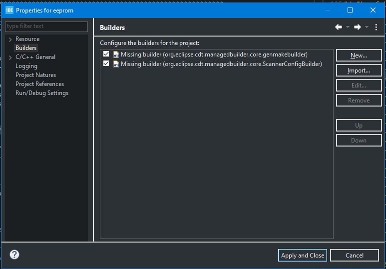

It worked fine 5 minutes ago. I was in v1.5.0.
I accepted the update, it installed correctly (apparently not), now I can't compile, create or edit any stm32 project.
All the existing projects show missing builders.

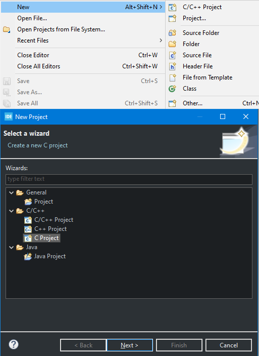

Can't create stm32 project (the option is gone).

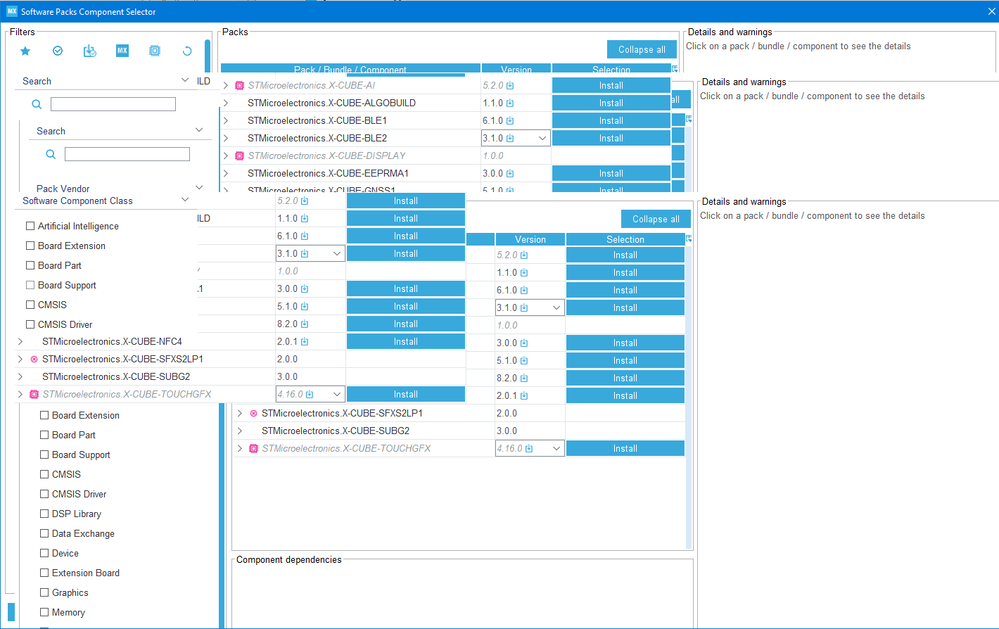

Warning! This build erases files!! I've keeping an eye at this since it came out. At first I thought it was me... But it has already wiped off 5 of my projects, being closed!
The first time as I couldn't use eGit at the moment due unknown bug, it got me totally unprepared. Thankfully I recovered everything using "restore from local history".
I don't know exactly how it happens, but if you copy an existing project (copy/paste in the existing project manager window) and work on it, maybe instantly, maybe tomorrow (it's pretty random) when you open again the original projetct, all the custom .c files will be gone, and the generated ones (main.c, etc) will be completely empty.
This never happened on 1.5.0 nor 1.3.0.
2021-01-01 4:44 AM
Also the CubeMX software manager appear totally distorted and broken,
