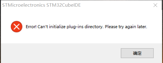

Hi, Zxals.1,
most of the users on this forum speak English. That's why I asked Google to translate your request, hopefully correct:
Excuse me, the installation of stm32cubeide prompts how to solve this problem. The installation file is stored in the root directory of the d disk. The administrator folder in the user directory of my c disk is in Chinese. Does this have an impact?
Possible answer:
It looks like you are installing in a customized folder: \stm32cubeide\d\c\c\用户\c
Please try to install STM32CubeIDE into a folder with minimum number of ANSI characters, e.g. C:\ST. The reason for this is the very long path length that the Eclipse and GNU GCC tools already contain.
Good luck!
When your question is answered, please close this topic by choosing Select as Best. This will help other users find that answer faster.
/Peter

OK, thank you very much. I defined the folder on disk d with the name st, then put the installation package in it, and then double-click it. But I still prompted that question. Does this have anything to do with the Chinese administrator directory of the user of Disk C, the default disk of my system
2021-01-04 5:04 AM
It doesn't matter where you put the installation package.
However, where you install the package is pretty important, i.e. the target folder of the installation. This destination folder is what I meant before.
