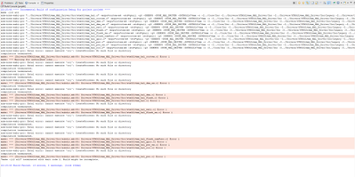

Hi. When I create SMT32 project (I'm using NUCLEO-L476RG) and then I compiled empty project I recive same 13 errors all the time(look photo below). I really can't fix it and I can't find the solution.
What I tried:
Thanks,
