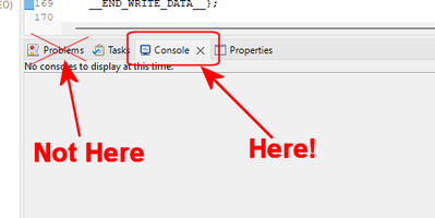

2024-03-19 3:53 AM - edited 2024-03-19 6:46 AM
go to the very first reported error
You need to look in the build console output - not in the 'Problems' list:
