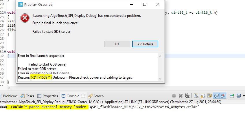

I have a little (but big) problem with customized external loader.
The compiler report this error: " ERROR: Couldn't parse external memory loader"

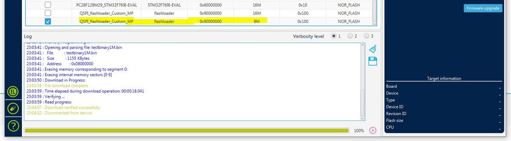

Stm32 Cubeprogrammer instead, tell me everything is OK.
I tried to download a simple file inside my QSPI external memory and it works correctly.
I don't what's the problem in stm32 IDE.
Does someone has some hints or idea?

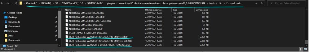

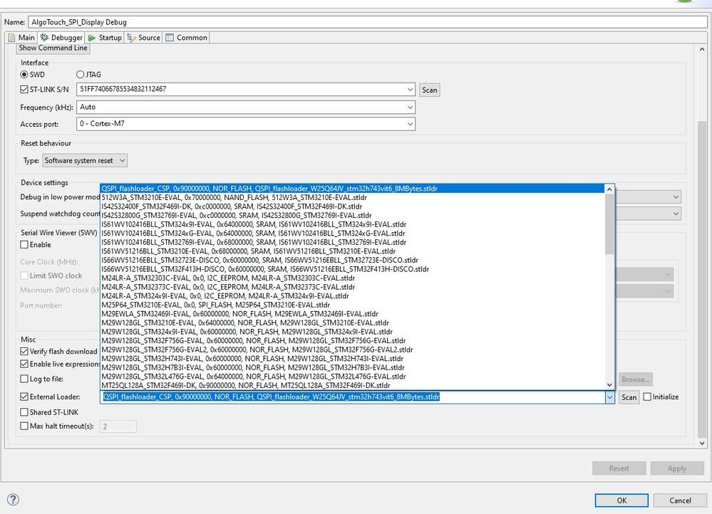

Second question:
Why I see only one custom loader on IDE instead of two, like on windows folder?
The result not change also after a reboot of the IDE?

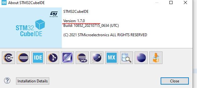

I'm using the latest IDE version:
Thanks in advance
Best regards.
Seems to be operating on Internal Memory
Seems to be a complaint about the form/structure of the ELF file, and the StorageInfo within.

Hi I have the same problem since updating to STM32Cube IDE 1.7.0. My external loader worked perfectly on 1.6.0. Any idea ??
If I downgrade back to 1.6.0 it works again.
Also, after installing STM32Cube IDE 1.7.0, there is no folder "STM32CubeIDE_1.7.0" in C:\ST.
My .stdlr files are still in C:\ST\STM32CubeIDE_1.6.0\STM32CubeIDE\plugins\com.st.stm32cube.ide.mcu.externaltools.cubeprogrammer.win32_1.6.0.202101291314\tools\bin\ExternalLoader but it seems that STM32Cube IDE 1.7.0 use the .stldr in that exact same folder
