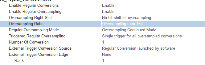

So I set both ADC to 16x of oversampling ratio as above.

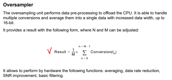

And if n is the number of conversions, and N is Oversampling ratio,
how N can be 256x? STM32G4 supports only 16 times of number of conversion.

The summation register can have 20 bits, but the result is only 16 bits. A shift can be applied, but has to be considered too.

looks only 16 times of single conversion..?

Yes, "Oversampling ratio 16x" is the correct setting to do 16x oversampling.

speaking of the setting, I am wodering if the number of conversion shouldnt 1 since the conversion results will be summed from the first (n=0) to the end(n = Number of conversion -1) and N should 16 if I want to get 16 bits result with the 16x oversampling ratio according to the equation above.
and also the ADCs are using only one channel each, ADC1 CH6 and ADC2 CH7,

I am confused the naming, the number of conversion which can be set 1 to 16 in the cubeide configurator. you can find it in the image above.
Is Conversion(tn) in the equation above the conversion result of t0 to t(N-1)?
where N is the nimber of conversion?

using ADC1 CH6, ADC CH7 with
dual regular simultaneous mode and
I set the number of conversion as 1, and the over sampling ratio as 16x, and the right shift as 0.
then according the equation, M will be 1,
and during the summation from n = 0 to 15,
Conversion(tn) will be the same result since the ADconversion is excuted only once? (Number of conversion is 1)
then the result will be just 16 times of the first sample result...
