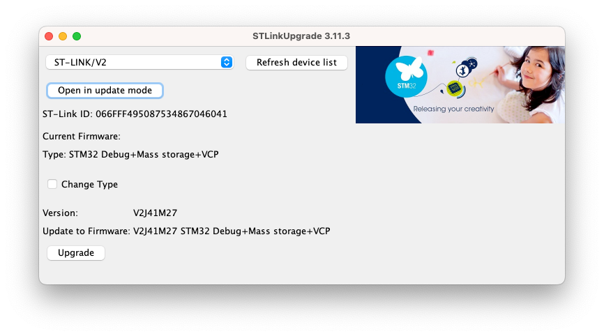

Just installed the tools and connected an STM32 Nucleo 144 for the first time.
After connecting it, a ST-Link upgrade window popped up about updating the firmware of the board which I did. Got the Upgrade successful message, but if I open this window again and choose the Open in update mode, the following option still shows up and lets me upgrade again.
