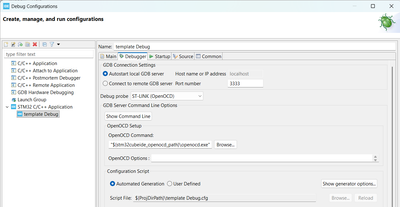

I'm having issues with the VSCode setup, so I'm trying to get it working using CubeIDE, but no luck so far, also when using OpenOCD the .cfg file can be found in the screenshot, also you can provide your own .cfg file
I'm seeing online many issues regarding stm32h7 and ITM, also the default OpenOCD config file for stm32h7 specifies that if hla is used for transport then ITM does not work.
So I'm looking for some more info on this.
