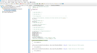

Generated the code with CubeMx, Compiled it with CubeIDE, Flashed and Run the code.
This is a screenshot of a debug session of your project with CubeIDE:
Could you please do the same manipulation on another PC?

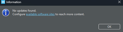

Here is the message when looking for an update:
2024-08-28 1:55 AM
Could you please uninstall CubeIDE and install the latest version?
