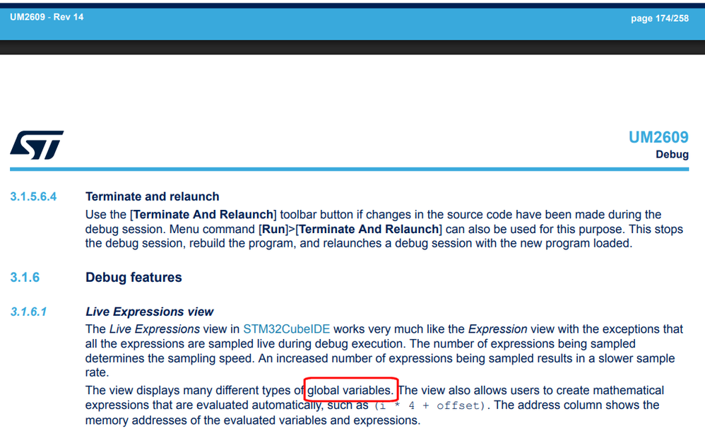

Apparently the problem is with `cnt` being a local variable. When I make it global, i.e., declared before `void run() { }` it works properly and Live Expressions shows a big number for it after pressing the button even only once.
2025-06-02 2:00 AM - edited 2025-06-02 2:11 AM
That's another issue with using "Live Expressions" - the things you're watching need to be permanently visible.
Making it static (but still local) might work;
Making it static at file scope should work ...
PS:
This is not specific to C++
The same would apply to plain C.
#LiveExpression #GlobalData
2025-06-02 2:10 AM
@STTwo-32 perhaps this is something which needs to be made clearer in the UM?
