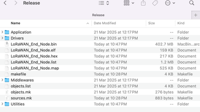

We re trying to compile LoRaWAN_END_Node project from STM32WL Cube library. CubeIDE generate 402 MB bin File. Can someone from STteam look into this.
MCU STM32WLE5CC
Mac Verion 1.0.3
WL 1.3.1

2025-03-27 6:57 PM
This is because the executable contains several data blocks at addresses very far away: 08000000 and 20008000.
The tool must output a single flat binary so it just does its best and fills the huge hole(s). Bottom line: the plain .bin file is not optimal format for this program. Why not just use the .hex?
