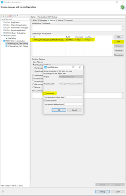

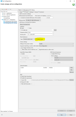

1-In debug configuration check "Halt all cores" in reset behavior
2-Go to the Startup tab and select [Edit…]>[Disable Download]. This is required since the download is already
performed by the Cortex®-M7 configuration

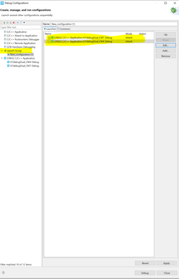

3- You can launch the debug session on both cores with only one launch configuration as shown below
