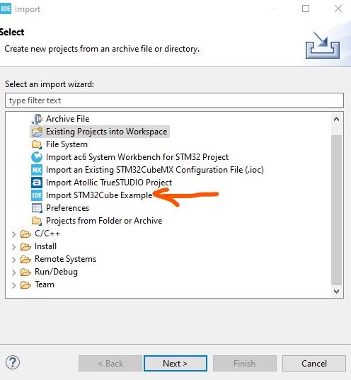

"copy project into workspace" is not supported at all because STM32Cube examples are heavily relying on symbolic link like Eclipse feature. Doing local copy is killer here because Eclipse does not manage link remapping properly then.
According to me such is part of documentation : https://www.st.com/resource/en/user_manual/dm00613836-migration-guide-from-system-workbench-to-stm32cubeide-stmicroelectronics.pdf
If expecting to copy locally example material, if hopefully part of supported ones, please rely on dedicated import example feature which is promoted as part of STM32CubeIDE
