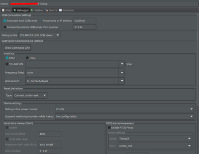

Hello @Gaston
Could you please share your Debug configuration, or your Log file?

Time elapsed during download operation: 00:00:00.480and the Debug Configuration

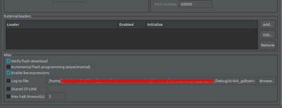

2025-11-13 8:08 AM
Just check "Log to file" in debug configuration so you can find your log.
