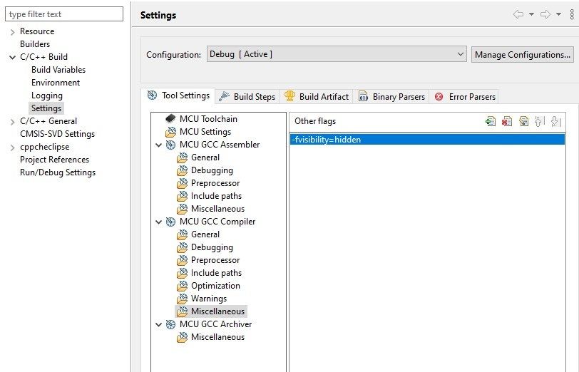

Here are the other GCC settings:
-mcpu=cortex-m4 -std=gnu11 -g3 -DDEBUG -DUSE_HAL_DRIVER -DSTM32G431xx -c -I../Drivers/CMSIS/Device/ST/STM32G4xx/Include -I../Drivers/CMSIS/Include -I../Inc -I../Drivers/STM32G4xx_HAL_Driver/Inc -I../Drivers/STM32G4xx_HAL_Driver/Inc/Legacy -I"C:\Users\TE228673\SW_Dev\STM32CubeIDE\workspace_1.7.0\KMX-D\DESIGN_DEMOS\PRIVATE_INCLUDE_FILE_TEST_LIB\Module\PrivateLogicFunctions\Inc" -I"C:\Users\TE228673\SW_Dev\STM32CubeIDE\workspace_1.7.0\KMX-D\DESIGN_DEMOS\PRIVATE_INCLUDE_FILE_TEST_LIB\Module\PublicLogicFunctions\Inc" -O0 -ffunction-sections -fdata-sections -Wall -fvisibility=hidden -v -fstack-usage --specs=nano.specs -mfpu=fpv4-sp-d16 -mfloat-abi=hard -mthumb
I am creating a static-lib project.
This project contains a lot of functions for internal use only. These functions MUST NOT be callable from outside the static lib.
Referring the: https://gcc.gnu.org/onlinedocs/gcc/Code-Gen-Options.html#Code-Gen-Options
This can usually be achieved by simply using the GCC flag:
-fvisibility=hidden
Unfortunately, this flag does not work in my project in CubeIde.
