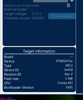

So show, pic, not error message - this is useless, CubeProgrammer, to both, and show, what its telling (chip ID etc.).
so:
2025-07-23 10:05 AM
Where can I find this information in the picture?

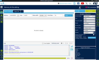

2025-07-23 10:10 AM
using CubeProgrammer, then connect:

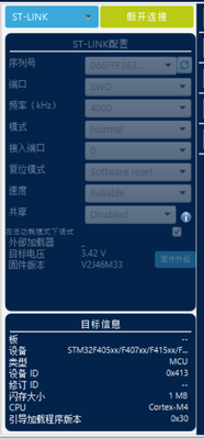

2025-07-23 7:33 PM - edited 2025-07-23 7:41 PM
Is that so?
This is the information of the chip that cannot be burned.

So you get connected to the chip:
It's basically working ok,
And is F4xx type, good, so far.
