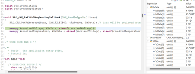

I am trying to convert floating point number to its byte representation to send through CAN Bus  HAL_CAN_AddMessage() and when I receive it I will convert back to its corresponding floating point number. I can convert the first floating point number to its byte representation and when I receive it back by the HAL_CAN_GetMessage() I convert it back to its floating point number. The first floating point number works fine. The problem occurs when I try to do the second one. I do not receive anything for the second one.

the first memcpy() works fine

the same data is in RxData and TxData

That the TxData buffer has the last 4 bytes as zero isn't exactly convincing that the data passed into SendFloatsOverCAN() are correct.
Print them out there, confirm they are as expected and temperature != 0
>>float temperature 21.98290;  I got this value by reading a register with 16bits and 2 bytes
floats are 4 bytes, not 2, show this, the value and the computation, I'm not convinced.
