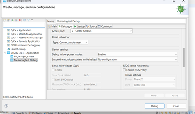

SWV is not selectable because Cortex-M0 and Cortex-M0+ do not contain SWV, as can be read in e.g. KAN-297 from ARM:
Serial Wire Viewer (SWV) is a data trace feature found on many ARM Cortex-M3, M4, M7, M23, and M33 processors. Cortex-M0 and Cortex-M0+ do not have SWV.

Can't work on Cortex-M0(+), need to use other methods.
Keil uses Event Recording https://www.keil.com/appnotes/files/apnt_321.pdf
Some STM32 CM0(+) have UART pins mappable to SWDIO/SWCLK allowing for diagnostic output and sometimes input, via those pins absent a debug pod.

2023-08-22 8:56 PM
https://deepbluembedded.com/stm32-debugging-with-st-link-v2-swd-serial-wire-viewer/
i am following above instruction .its enanle in above microcontroller,why not in mine ?
2023-08-22 9:08 PM
To repeat once more, the SWV functionality is NOT implemented in CM0(+) cores, but is in CM3 and CM4(F)
The STM32F1 is a Cortex-M3 processor, the STM32L4 is a Cortex-M4F processor.
