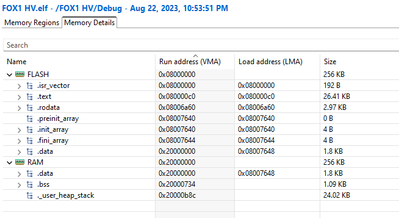

2023-08-22 10:31 AM
I tried with the below setting:
RAM (xrw) : ORIGIN = 0x20000000, LENGTH = 256K
FLASH (rx) : ORIGIN = 0x8000000, LENGTH = 256K
It compiled successfully, but I am still not able to figure out what needs to be changed?

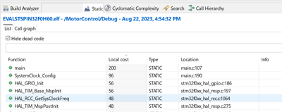

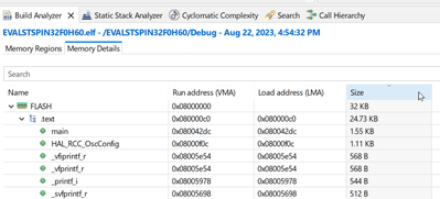

It compiled without errors. I am still not able to figure out what needs to be changed to get it right. Below is the screen shot of the bug analyser
